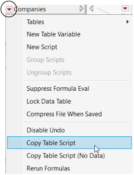

1. In the data table, select the red triangle next to the data table’s name.
2. Select Copy Table Script.
Figure 3.3 Copy the Table Script
3. Open a script window by selecting File > New > Script.
4. Select Edit > Paste.
You now have a script that duplicates your data table. You can save this script and run it at any time to recreate your data table, with all its scripts attached.
