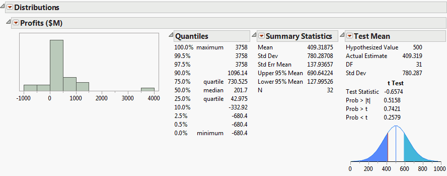

From the red triangle menu next to Profits ($M), deselect Outlier Box Plot to turn the option off.
8.
Type 500 in the Specify Hypothesized Mean box.
9.
图 3.1 Customized Distribution Report

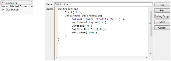

图 3.2 Distribution Script Saved to the Data Table
