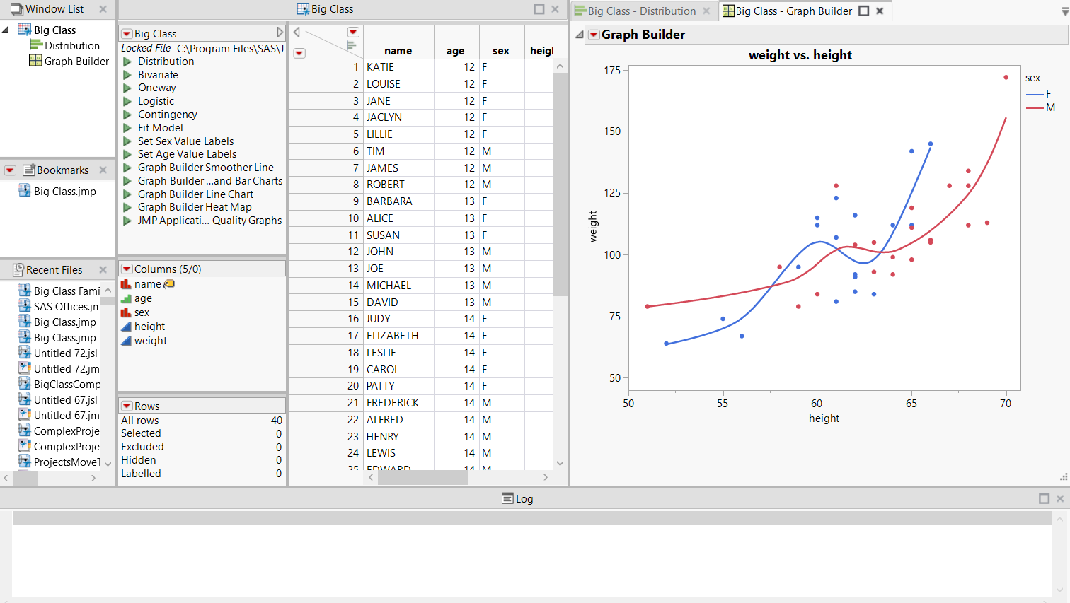

A more complicated project might include a Bookmarks pane (to show file, folders, and groups that use frequently), and a project log. The data table and output are in separate tabs.
Begin by creating a new project and creating a bookmark.
project = New Project();
project << Add Bookmarks({
              File( "$SAMPLE_DATA/Big Class.jmp" )
Run Script opens the data table and creates output inside the project.

Set Layout specifies the layout of the tabs that show the data table and output.
project << Set Layout(
		V Splitter Box(
			Size( 1215, 700 ),
			<<Set Sizes( {0.77, 0.23} ),
			<<Dockable(),
			V Splitter Box(
				Size( 1215, 540 ),
				<<Set Sizes( {1} ),
				<<Dockable(),
				H Splitter Box(
					Size( 1215, 540 ),
					<<Set Sizes( {0.11, 0.42, 0.47} ),
					<<Dockable(),
					V Splitter Box(
						Size( 128, 540 ),
						<<Set Sizes( {0.33, 0.33, 0.33} ),
						<<Dockable(),
						Tab Page Box(
							Title( "Window List" ), // show the Window List
							Window ID( "Window List" )
						Tab Page Box(
							Title( "Bookmarks" ), // show the Bookmarks pane
							Window ID( "Bookmarks" )
						Tab Page Box(
							Title( "Recent Files" ), // show the Recent Files pane
							Window ID( "Recent Files" )
					Tab Page Box( // show the data table
						Title( "Big Class" ),
						Window ID(
							"data"
					Tab Box(
						<<Dockable(),
						Tab Page Box( // show the Distribution graph and reports
							Title( "Big Class - Distribution" ),
							Window ID(
								"distrib"
						Tab Page Box( // show the Graph Builder graph
							Title( "Big Class - Graph Builder" ),
							Window ID(
								"graphbuilder"
			Tab Page Box( Title( "Log" ), Window ID( "Log" ) )
