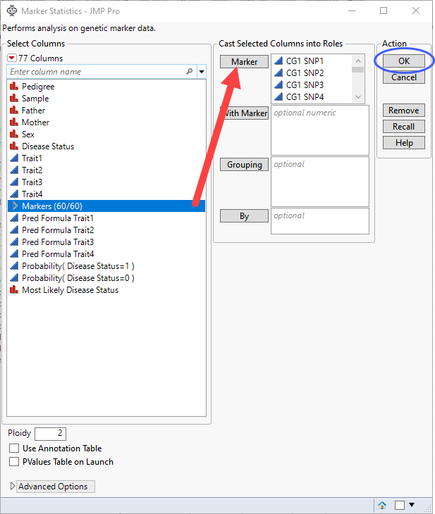

8      Select Analyze > Genetics > Marker Statistics.
8      Select the Markers group as the Markers.
8      Click OK.

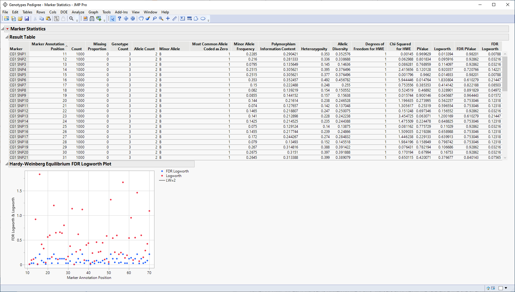

The following report is generated:
The Result table provides statistics for each of the markers analyzed.
The Hardy-Weinberg Equilibrium plot shows how close each of the markers are to equilibrium. The column number of each marker in the JMP table is plotted on the x-axis. The Logworth-adjusted p-value and -log10(p-value) for HWE for each marker is plotted on the y-axis. Markers at or below the reference line are at equilibrium, markers above the line are not. The farther from the reference a marker is, the further the marker is from equilibrium.

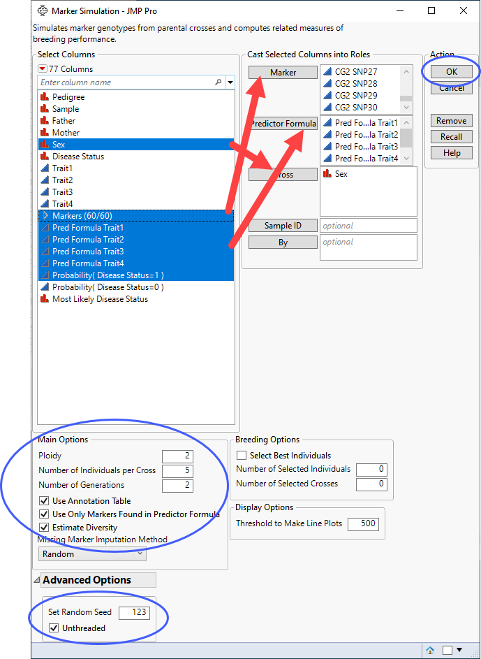

8      Select Analyze > Genetics > Marker Simulation.
8      Select Markers (60/0) and click .
8      Select Pred Formula Trait1, Pred Formula Trait2, Pred Formula Trait3, Pred Formula Trait4, and Probability (Disease Status=1) and click .
8      Select Sex and click .
8      Enter 2 for Ploidy.
8      Enter 5 for the Number of Individuals per Cross.
8      Enter 2 for the Number of Generations.
8      Check the Use Annotation Table, Use Only markers Found in the Predictor Formula, and Estimate Diversity check boxes.
8      Under Advanced Options, enter 123 for Set Random Seed.
8      Check the Unthreaded check box.
8      Click OK.

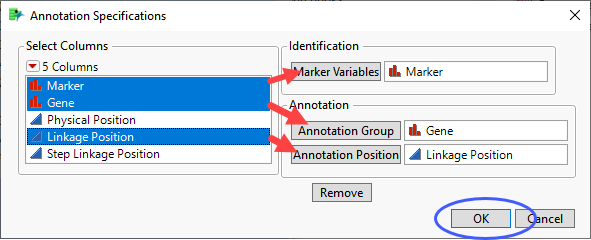

8      In the Choose Annotation Table window, select the Genotypes Pedigree Anno.jmp annotation data table and click .
8      In the Annotation Specifications window, select Marker and click .
8      Select Gene and click .
8      Select Linkage Position and click .
8      Click .
