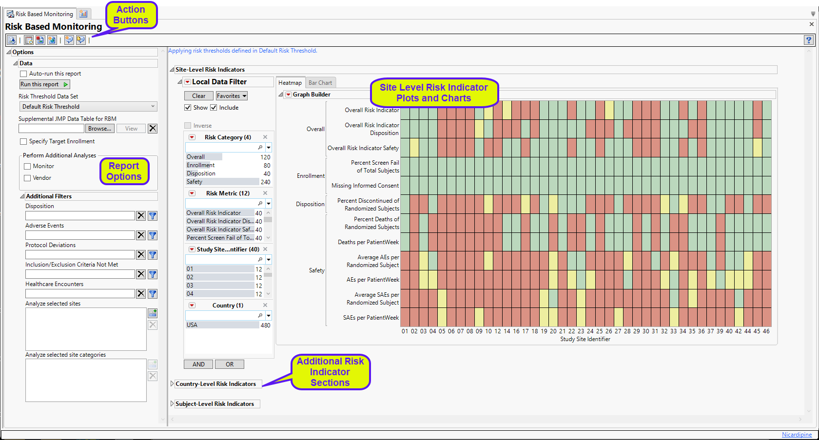

Report Results Description
Running Risk Based Monitoring with the default options for the Nicardipine study generates the Results shown below. By default risk-indicators are calculated at site, country, and subject levels . A heat map and a bar chart are provided for both site and country level. Associated data tables are also provided.
The Report contains the following elements:

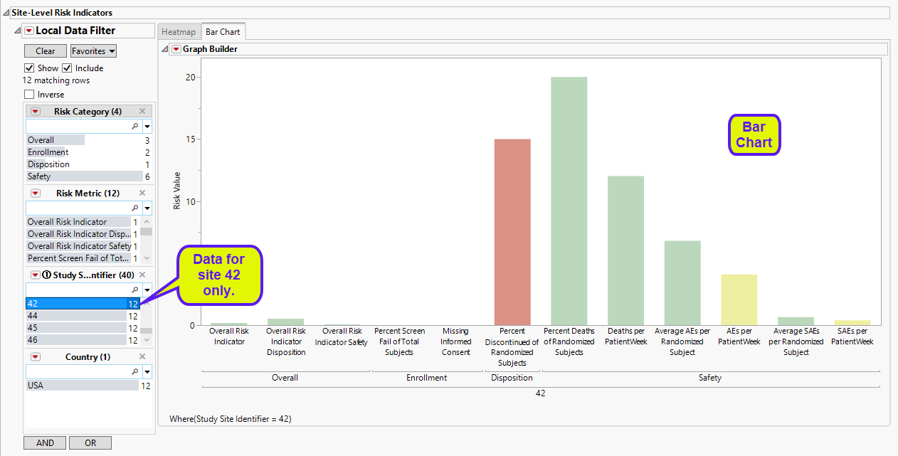

Site-Level Risk Indicators
The Site-Level Risk Indicators section contains the following elements:
• | A heat map of the various risk indicators by Site Identifiers. Individual blocks are colored by the relative severity of each indicator at that site: red = severe, yellow = moderate, green = mild or none. This section enables you to view the distribution of risk indicators across sites, possibly identifying any outliers. |
• | A Local Data Filter to filter to data of interest, for example, to risk indicators that belong to a particular site. |
• | A bar chart showing the risk value for each indicator across the sites. The data in the following bar chart were filtered to site 42 only. |

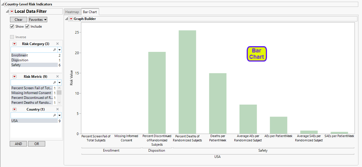

Country-Level Risk Indicators
The Country-Level Risk Indicators section contains the following elements:
• | A heat map of the various risk indicators by Country Identifiers. Individual blocks are colored by the relative severity of each indicator at that site: red = severe, yellow = moderate, green = mild or none. This section enables you to view the distribution of risk indicators across countries, possibly identifying any outliers. |
• | Note: All of the trial sites are located within the United States, so only one country is displayed. |
• | A Local Data Filter to filter to data of interest, for example, to risk indicators that belong to certain risk categories. |
• | A bar chart showing the risk value for each indicator. across the sites. |

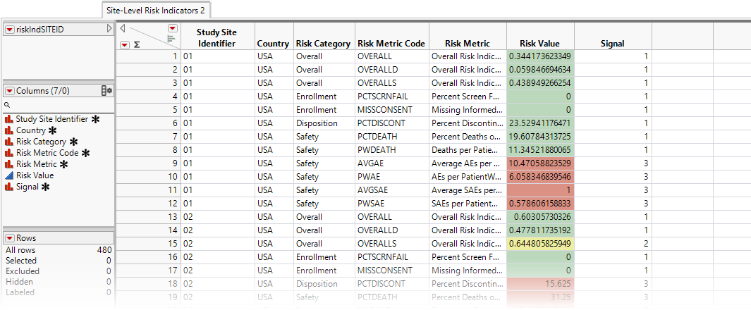

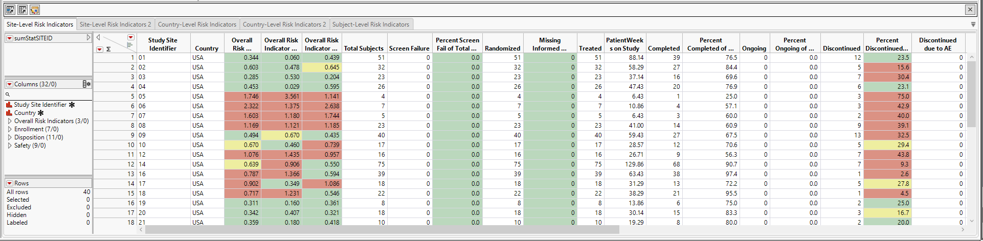

• | Site-Level Risk Indicators: This data table displays risk indicators summarized at the site level. Risk indicators with defined thresholds are colored in green, yellow, or red. Each site-level risk indicator is in a separate column. This is a "short" and "wide" data table. |
• | Site-Level Risk Indicators 2: This data table displays risk indicators summarized at the site level. It contains only those risk indicators that have a defined threshold and they are colored in green, yellow, or red. All the risk values are stacked in the same column: Risk Value. The risk indicator name is stored in the Risk Metric column. This is a "long" and "narrow" data table. |

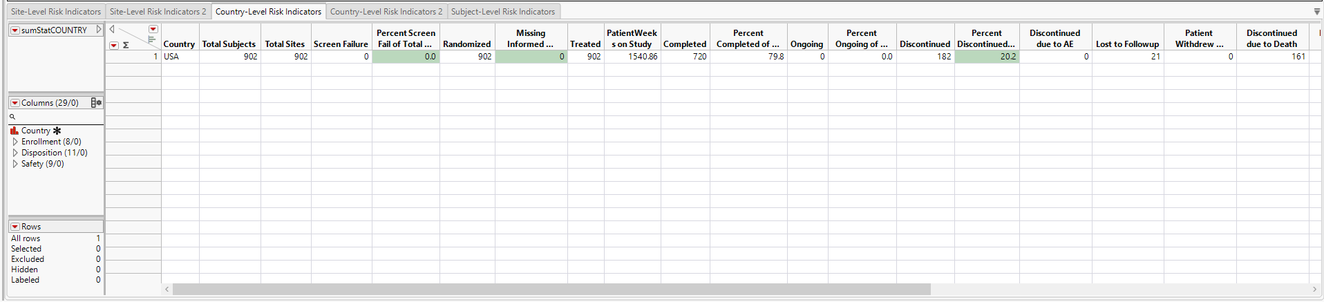

• | Country-Level Risk Indicators: This data table displays risk indicators summarized at the country level. Risk indicators with defined thresholds are colored in green, yellow, or red. Each country-level risk indicator is in a separate column. This is a "short" and "wide" data table. |
• | Country-Level Risk Indicators 2: This data table displays risk indicators summarized at the country level. It contains only those risk indicators that have a defined threshold and they are colored in green, yellow, or red. All the risk values are stacked in the same column: Risk Value. The risk indicator name is stored in the Risk Metric column. This is a "long" and "narrow" data table. |

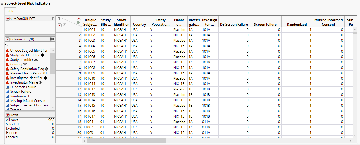

Overall risk indicators are calculated as , where
, or
for Direction equal to B (both), U (upper), or L (lower), respectively.The wj are weights for the overall risk indicator; 1 by default.
Refer to How are risk thresholds defined? for more information.
