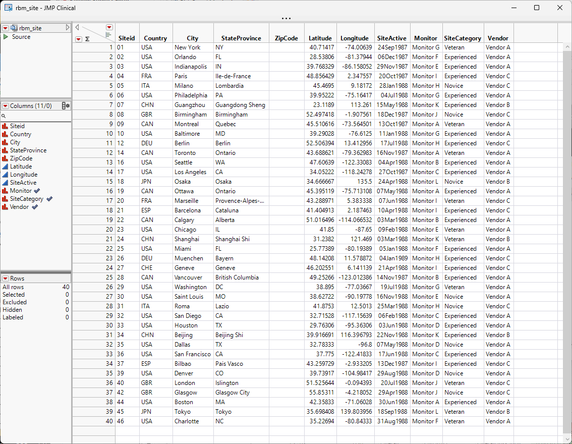

Example
A Site Details data table for the Nicardipine example is included with JMP Clinical and it is called NicardipineRBM_en.jmp for English locale. If locale is Chinese, then the file is Nicardipine_zh.jmp and if it is Japanese, then the file is NicardipineRBM_zh.jmp. This file can be found in the Notes directory of the Nicardipine study, if Nicardipine is registered in JMP Clinical (C:\Users\username\Documents\JMPClinical18\Configurations\Default\Notes\Nicardipine on Windows and in /Users/username/Documents/JMPClinical18/Configurations/Default on Macs) or in the installation folder (C:\ProgramData\JMP\JMPClinical\18\Clinical\Sample Data\Nicardipine on Windows).
Note especially the three highlighted columns; these correspond to options on the RBM report.
