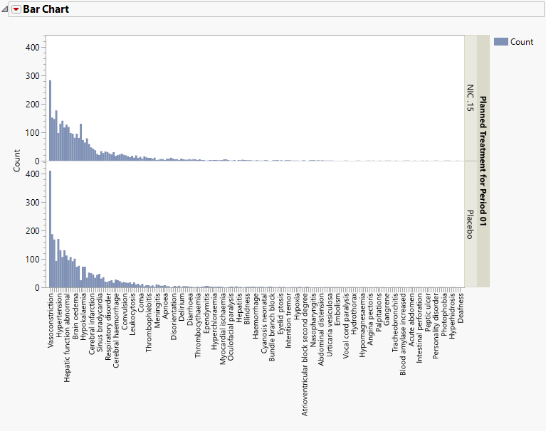

Bar Chart
Using a Bar Chart or Tree Map, this section summarizes the distributions of terms based on xxDECOD or, if unavailable, xxTERM or xxTRT depending on CDISC domain type. Results are summarized by selected demographic grouping and can be displayed as total counts .
In the example shown here, Dictionary-Derived Term counts by treatment are displayed.

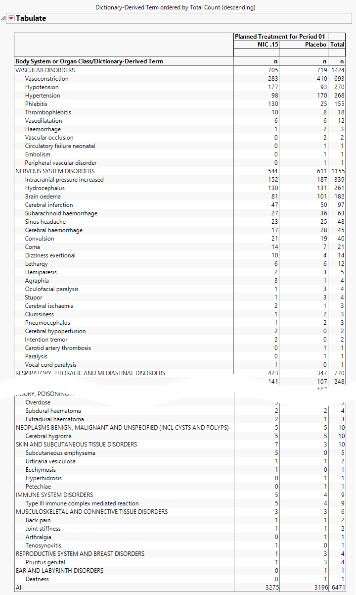

Tabulate
The Tabulate section contains one Table detailing the counts for each treatment group, for each dictionary-derived term within each body system or organ class. The counts, represented by n, are the number of subjects who experienced the given adverse event. The All row at the bottom of the table is the total number of adverse events in the given treatment arm.

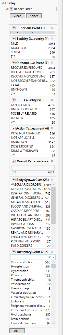

Report Data Filters
These filters enable you to subset and view subjects based on demographic characteristics and other criteria. Refer to Data Filter for more information.

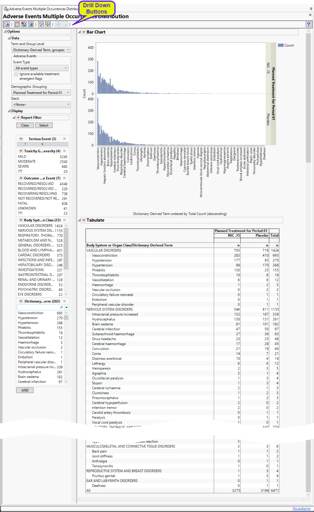

Action buttons, provide you with an easy way to drill down into your data. The following action buttons are generated by this report:
Click to rerun the report using default settings.
Click to view the associated data tables. Refer to Show Tables/View Data for more information.
Click to generate a standardized pdf- or rtf-formatted report containing the plots and charts of selected sections.
Click to generate a JMP Live report. Refer to Create Live Report for more information.
Click to take notes, and store them in a central location. Refer to Add Notes for more information.
Click to read user-generated notes. Refer to View Notes for more information.
Click to open and view the Review Subject Filter.
Click to specify Derived Population Flags that enable you to divide the subject population into two distinct groups based on whether they meet very specific criteria.
