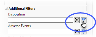

8 Click from the Disposition filter

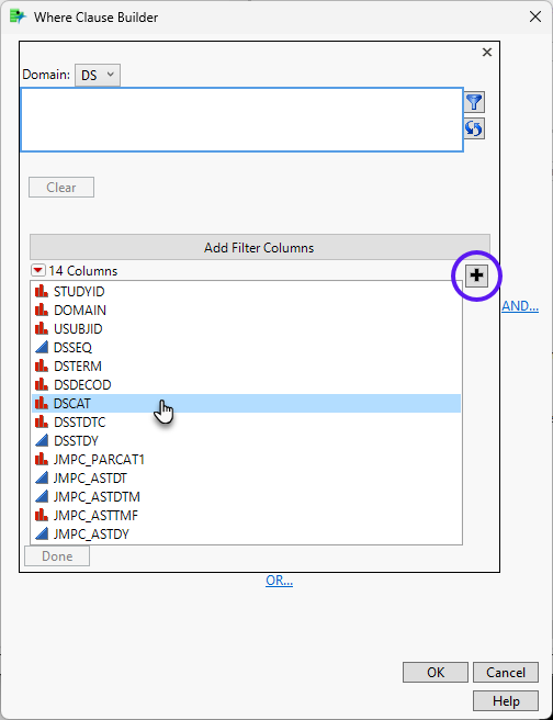

The Where Clause Builder opens.

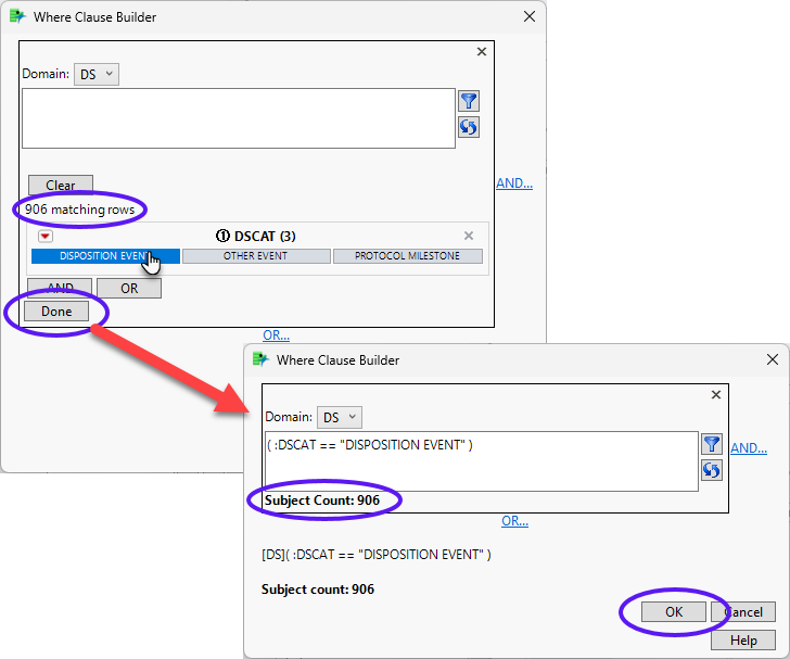

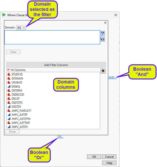

The DS domain is automatically selected as the domain. All of the columns in the domain are listed and are available for selecting.
8 Double-click on a column to select that column. In this example, we select DSCAT and click .
The column list changes to a list of the different term categories contained in the selected column.
8 Select DISPOSITION EVENT and click . You can see that we have selected 906 observations which account for the 906 subjects in the Nicardipine study.

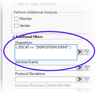

8 Click to add the filter to the report.

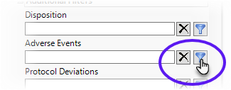

8 Click from the Adverse Events filter

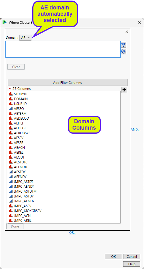

The Where Claussubppe Builder opens.
The AE domain is automatically selected as the domain. All of the columns in the domain are listed and are available for selecting.

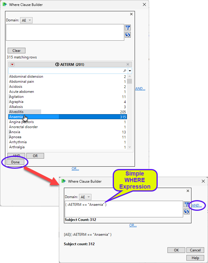

8 Click on a column to select that column. In this example, we select AETERM and click .
8 Select Anaemia and click to generate the simple WHERE expression.

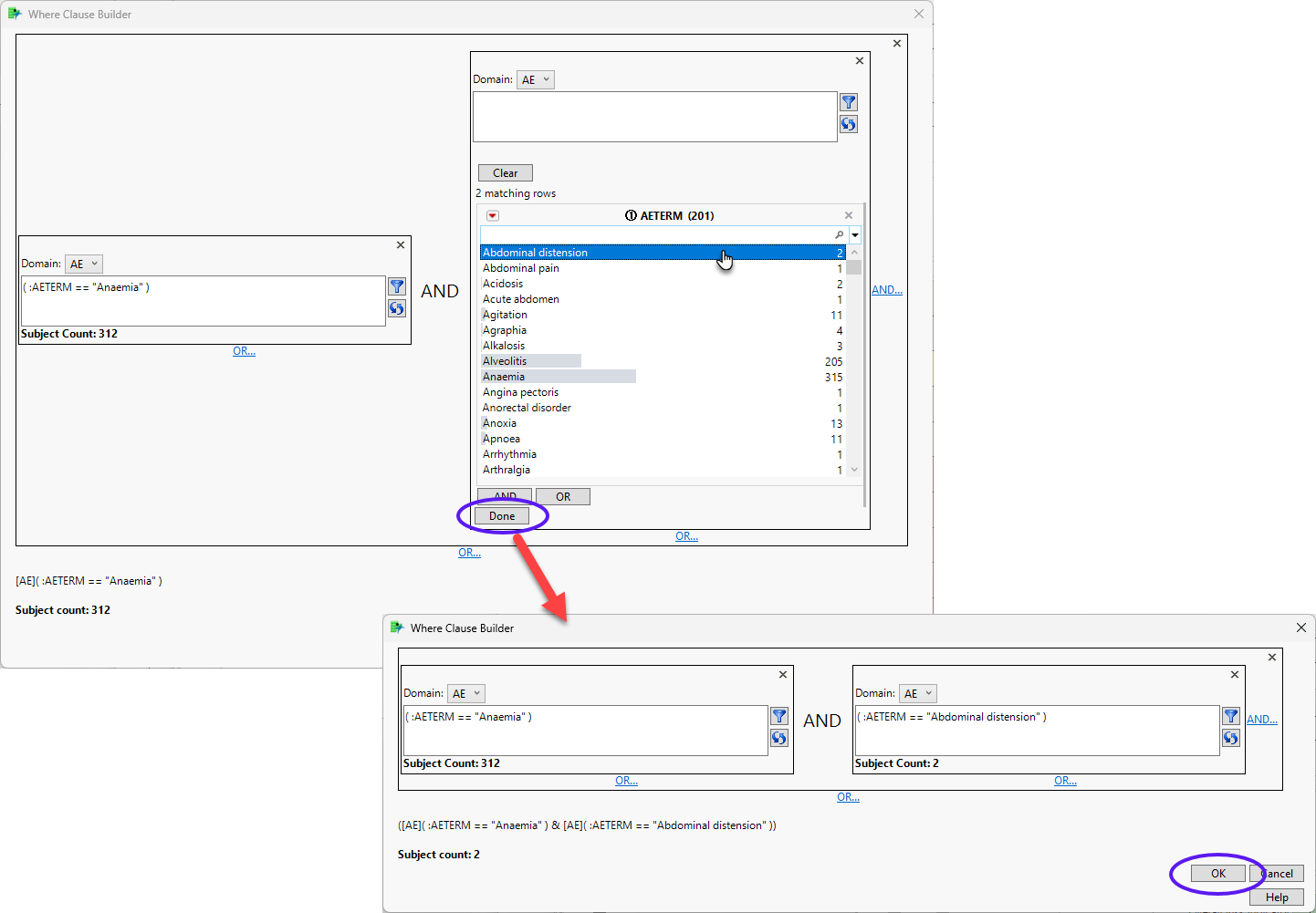

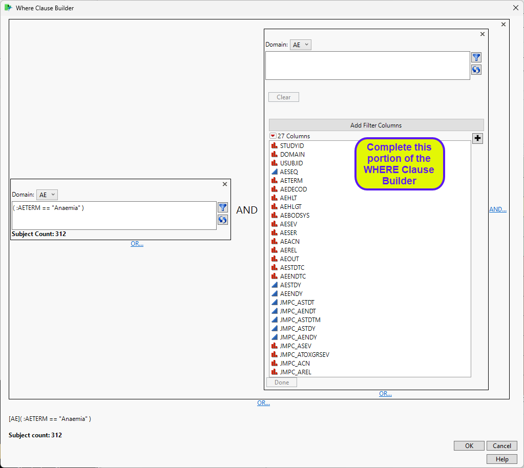

8 Click (circled above) to generate a complex WHERE expression.
To complete the second portion of the expression, where AETERM is Abdominal Distension:

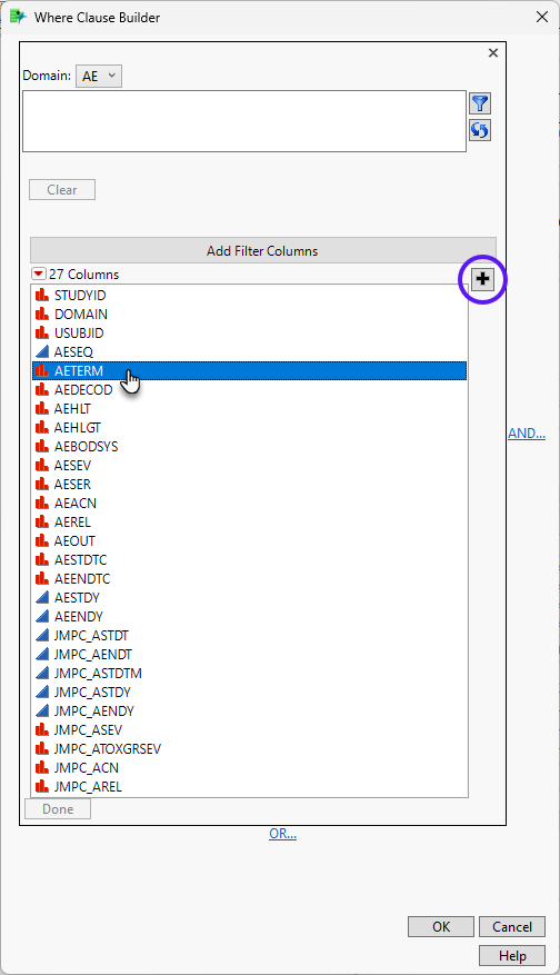

8 Select AETERM and click .

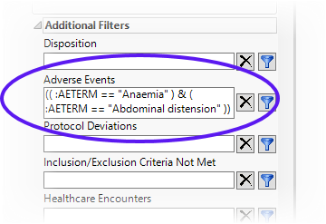

8 Click . to add the WHERE expression is added to the filter in the report.
