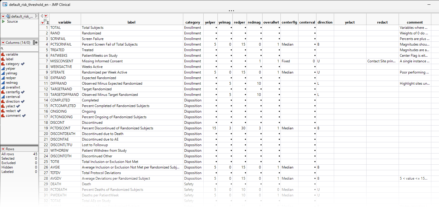

In order to run the Risk Based Monitoring report a third external file is needed that defines the risk thresholds. JMP Clinical ships with the Default Risk Threshold data table (shown below) so that you can begin performing your RBM analysis as soon as possible, and to assist with developing your own risk threshold data sets. Refer to Manage Risk Threshold Data Tables... for more information on generating and modifying the risk threshold table.
Note: You should refer to How does JMP Clinical define various terms for risk-based monitoring? for information about how terms used in risk-based monitoring are defined.

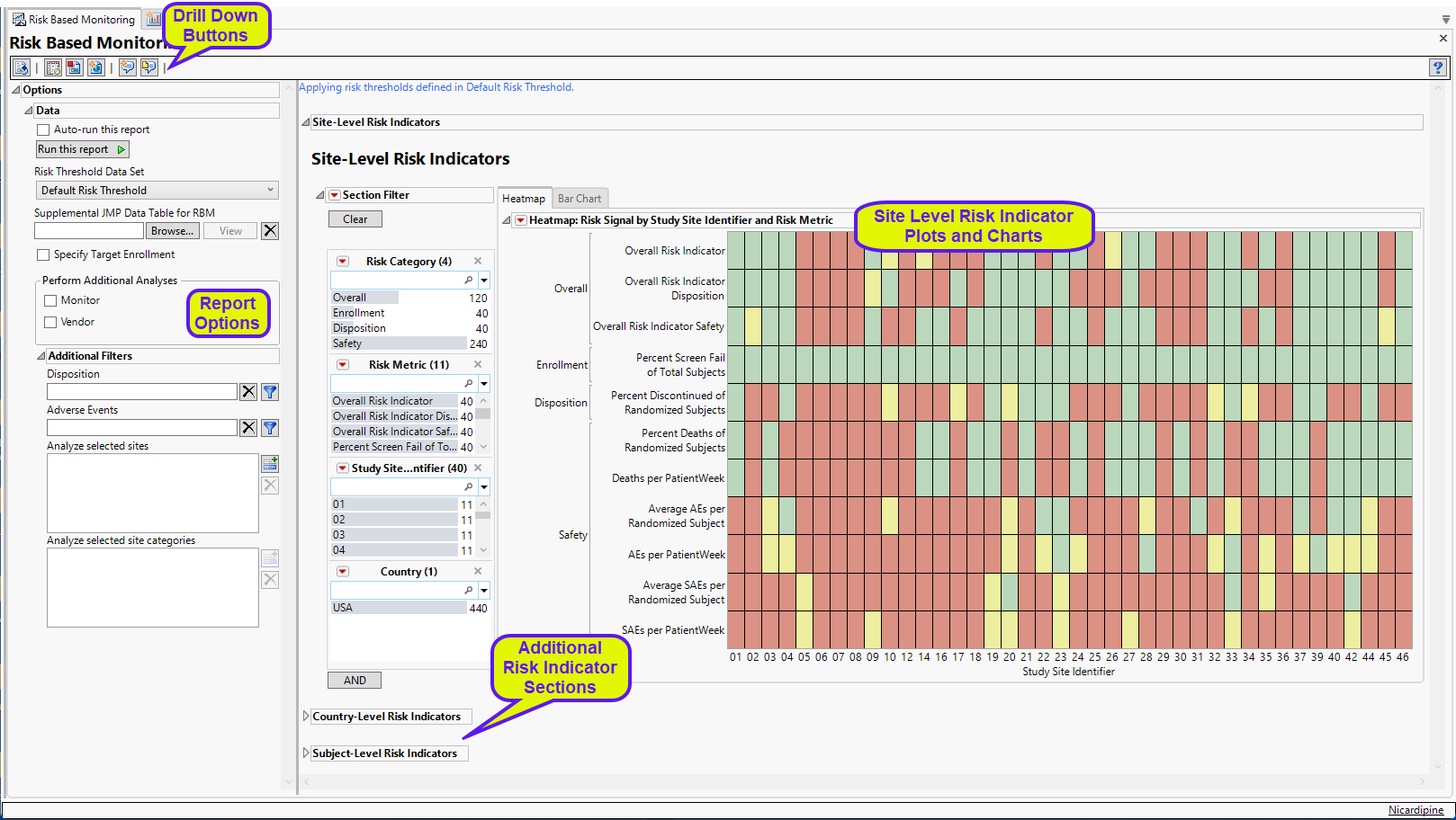

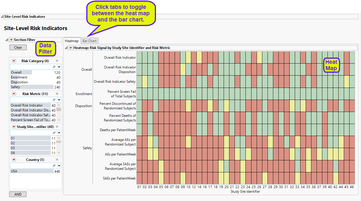

Running Risk Based Monitoring with the default options for the Nicardipine study generates the Results shown below. By default risk-indicators are calculated at site, country, and subject levels . A heat map and a bar chart are provided for both site and country level. Associated data tables are also provided.
The Report contains the following elements:

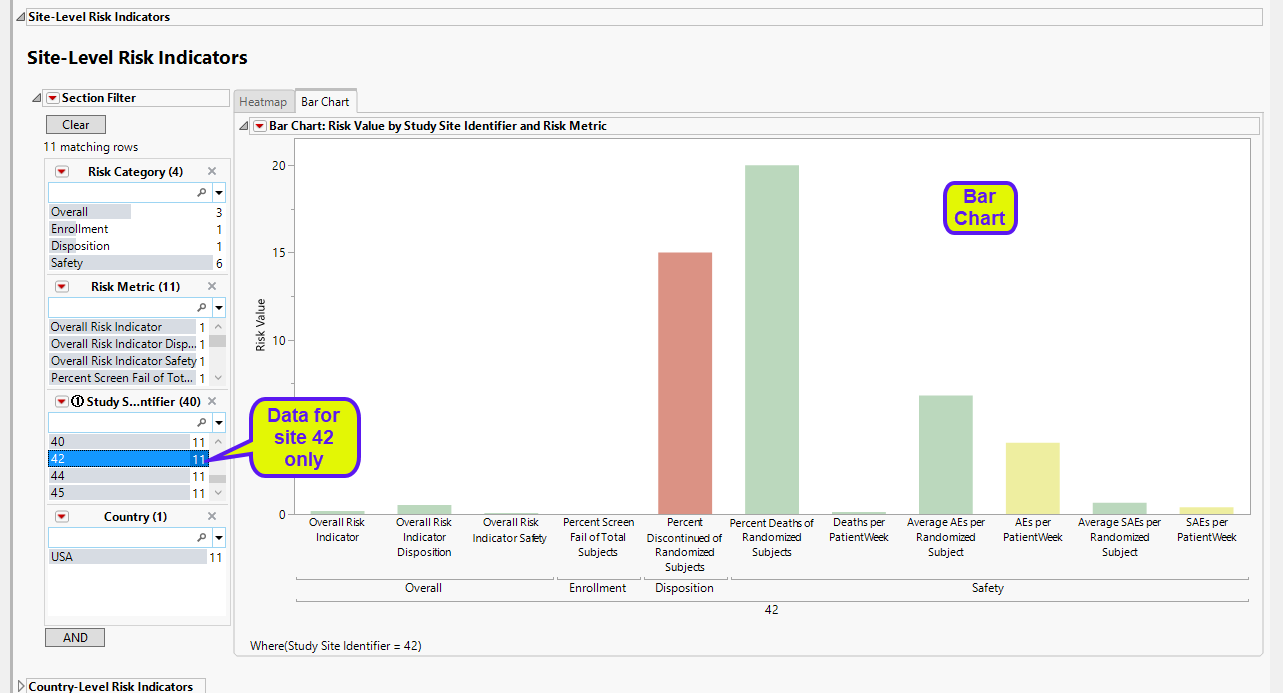

Site-Level Risk Indicators
The Site-Level Risk Indicators section contains the following elements:
A heat map of the various risk indicators by Site Identifiers. Individual blocks are colored by the relative severity of each indicator at that site: red = severe, yellow = moderate, green = mild or none. This section enables you to view the distribution of risk indicators across sites, possibly identifying any outliers.
A Section Filter to filter to data of interest, for example, to risk indicators that belong to a particular site.
A bar chart showing the risk value for each indicator across the sites. The data in the following bar chart were filtered to site 42 only.

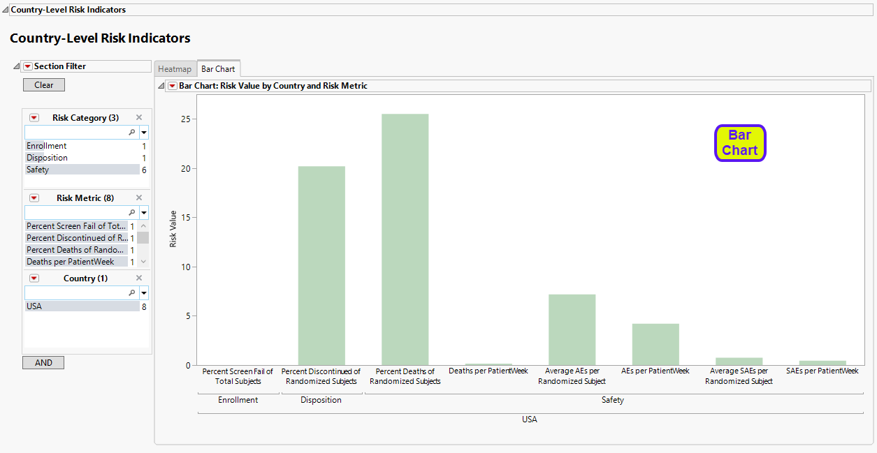

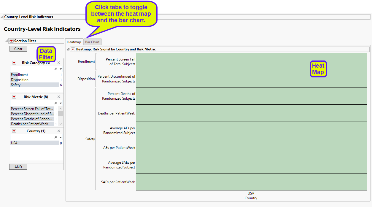

Country-Level Risk Indicators
The Country-Level Risk Indicators section contains the following elements:
A heat map of the various risk indicators by Country Identifiers. Individual blocks are colored by the relative severity of each indicator at that site: red = severe, yellow = moderate, green = mild or none. This section enables you to view the distribution of risk indicators across countries, possibly identifying any outliers.
Note: All of the trial sites are located within the United States, so only one country is displayed.
A Section Filter to filter to data of interest, for example, to risk indicators that belong to certain risk categories.
A bar chart showing the risk value for each indicator. across the sites.

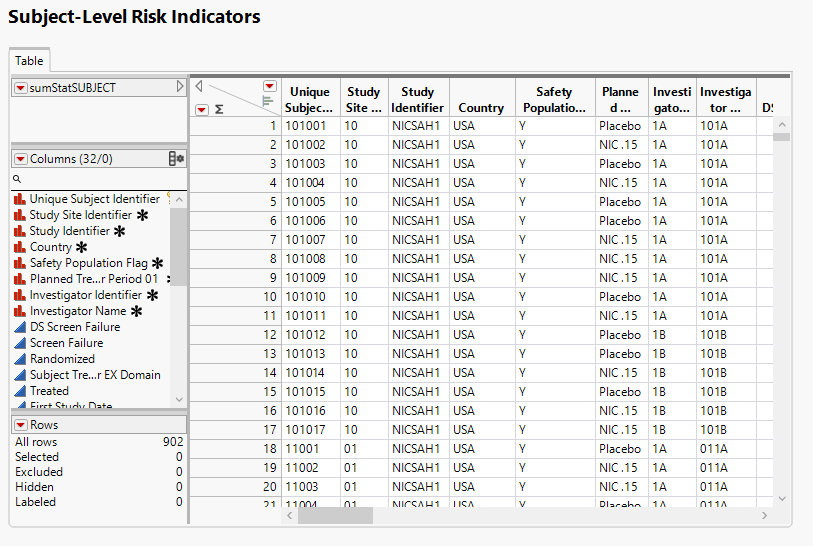

Subject-Level Risk Indicators
The Subject-Level Risk Indicators section contains the following elements:
A table listing the risk indicators of each subject.

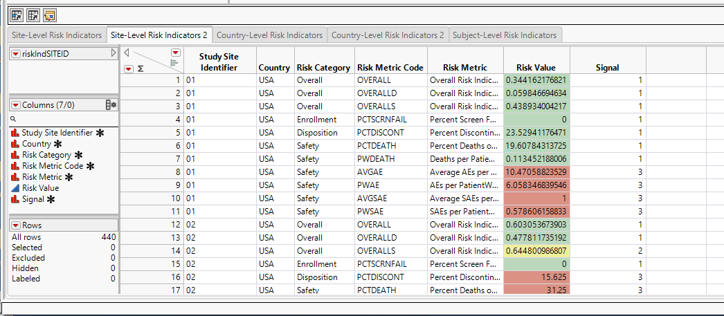

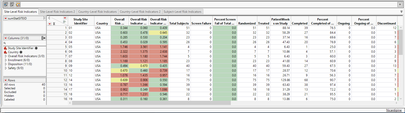

Output Data
You can view the output data tables by clicking on the action button. The data tables display risk indicators derived using the study database as well as data included in the optional supplemental data set. Two data tables are generated for each level except subject-level. The two tables at each level contain the same information, but they are organized differently.
Site-Level Risk Indicators: This data table displays risk indicators summarized at the site level. Risk indicators with defined thresholds are colored in green, yellow, or red. Each site-level risk indicator is in a separate column. This is a "short" and "wide" data table.
Site-Level Risk Indicators 2: This data table displays risk indicators summarized at the site level. It contains only those risk indicators that have a defined thresholRd and they are colored in green, yellow, or red. All the risk values are stacked in the same column: Risk Value. The risk indicator name is stored in the Risk Metric column. This is a "long" and "narrow" data table.

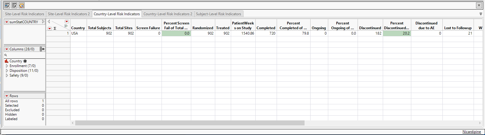

Country-Level Risk Indicators: This data table displays risk indicators summarized at the country level. Risk indicators with defined thresholds are colored in green, yellow, or red. Each country-level risk indicator is in a separate column. This is a "short" and "wide" data table.
Country-Level Risk Indicators 2: This data table displays risk indicators summarized at the country level. It contains only those risk indicators that have a defined threshold and they are colored in green, yellow, or red. All the risk values are stacked in the same column: Risk Value. The risk indicator name is stored in the Risk Metric column. This is a "long" and "narrow" data table.
This is the same table displayed in the Subject-Level Risk Indicators section above.
Note: If monitor and vendor information is provided through the site-level supplemental data, then graphs and data tables at monitor and vendor level will be provided as well.

Risk Threshold Data Set
The risk threshold data set is used as a reference to identify and label levels of risk in the Study. Use the drop down menu to select the risk threshold data set to use in the analysis. Refer to Risk Threshold Data Set for more information about risk threshold data sets.
