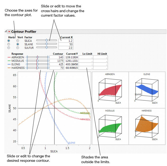

Use the interactive Contour Profiler for optimizing response surfaces graphically. The Contour Profiler shows contours for the fitted model for two factors at a time. The report also includes a surface plot.
Contour Profiler
shows a contour profiler view for the
Tiretread.jmp
sample data table. Run the data table script
RSM for 4 Responses
and select
Profilers > Contour Profiler
from the Least Squares Fit report menu.
