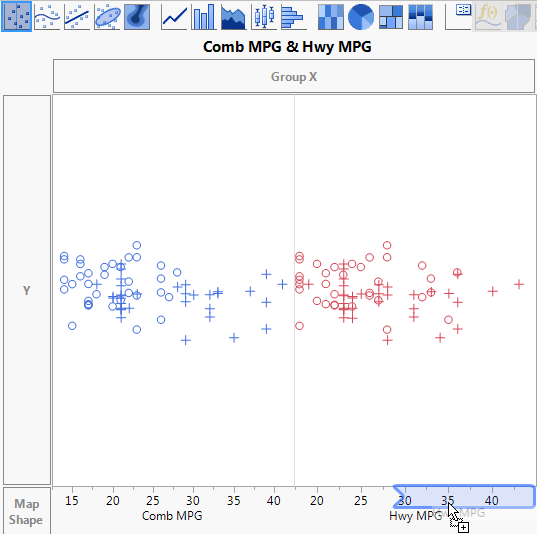

To quickly plot multiple variables against separate axes in the X zone:
1.
Select the columns in the Variables list.
2.
Click
Shift
and then click the
X
zone.
If you want more control over where the variables appear, drag them individually. Drag additional variables above, below, or between existing variables in the X zone.
Dragging a Variable to the Right of the Existing Variable
A single polygonal shape indicates when your variable is in the appropriate target zone.

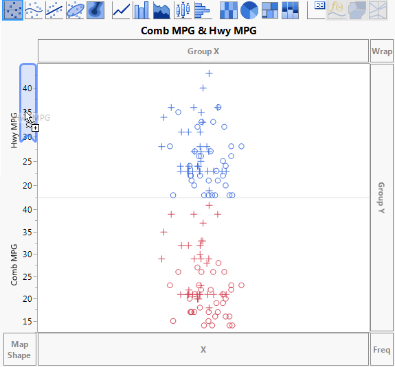

To quickly plot multiple variables against separate axes in the Y zone:
1.
2.
Click
Shift
and then click the
Y
zone.
If you want more control over where the variables appear, drag them individually. Drag additional variables above, below, or between existing variables in the Y zone.
Dragging a Variable above the Existing Variable
