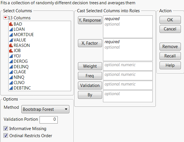

Launch the Bootstrap Forest Platform
• Launch Window
Launch Window
Bootstrap Forest Launch Window
The Bootstrap Forest platform launch provides the following options:
Y, Response
The response variable or variables that you want to analyze.
X, Factor
The predictor variables.
Weight
A column whose numeric values assign a weight to each row in the analysis.
Freq
Validation
A numeric column that contains at most three distinct values. See
Validation
in Partition Models
By
A column or columns whose levels define separate analyses. For each level of the specified column, the corresponding rows are analyzed using the other variables that you have specified. The results are presented in separate reports. If more than one By variable is assigned, a separate report is produced for each possible combination of the levels of the By variables.
Method
Enables you to select the partition method (Decision Tree, Bootstrap Forest, Boosted Tree, K Nearest Neighbors, or Naive Bayes). These alternative methods, except for Decision Tree, are available in JMP Pro.
For more details on these methods, see
Partition Models
Boosted Tree
K Nearest Neighbors
, and
Naive Bayes
Validation Portion
The portion of the data to be used as the validation set. See
Validation
in Partition Models
Informative Missing
If selected, enables missing value categorization for categorical predictors and informative treatment of missing values for continuous predictors. See
Informative Missing
in Partition Models
Ordinal Restricts Order
If selected, restricts consideration of splits to those that preserve the ordering.
