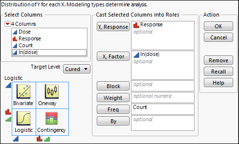

To perform a Logistic analysis, do the following:
1.
Select
Analyze > Fit Y by X
2.
Enter a nominal or ordinal column for Y, Response.
3.
Enter a continuous column for X, factor.
The schematic indicates that you will be performing a logistic analysis.
Note:
You can also launch a logistic analysis from the JMP Starter window. See
Launch Specific Analyses from the JMP Starter Window
Fit Y by X Logistic Launch Window
When the response is binary and has a nominal modeling type, a Target Level menu appears in the launch window. Use this menu to specify the level of the response whose probability you want to model.
For more information about the Fit Y by X launch window, see
Introduction to Fit Y by X topic
