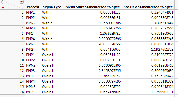

The Make Goal Plot Summary Table option produces a summary data table that includes each variable’s name, its spec-normalized mean shift (Mean Shift Standardized to Spec), and its spec-normalized standard deviation (Std Dev Standardized to Spec). For each variable, there is a row for each of the two sigma types (Within and Overall).
Note:
If a variable is fit with a distribution other than normal, the name of the fitted distribution is appended parenthetically to the variable name. The Mean Shift Standardized to Spec and Std Dev Standardized to Spec values are not provided for nonnormal variables.
The points in the Goal Plot are linked to the rows in the Goal Plot Summary Table. If you apply row states to a point in the Goal Plot, you can change the corresponding row states in the Goal Plot Summary Table. Conversely, if you apply row states in the Goal Plot Summary Table, they are reflected on the Goal Plot.
Summary Table
shows the Goal Plot Summary Table for the
Semiconductor Capability.jmp
sample data table as described in
Example of the Process Capability Platform with Normal Variables
Summary Table
