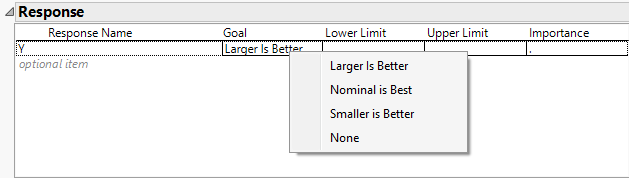

The Responses outline contains the following columns:
Response Name
The name of the response. The default response name is
Y
. To change this name, double-click it and enter the desired name.
Goal, Lower Limit, Upper Limit
Select one of the following Goals: Larger Is Better, Nominal is Best, Smaller is Better, or None. When you create your design, JMP saves a formula for the SN Ratio to the data table that reflects your selected goal.
Importance
Because there is only one response, specifying the Importance is unnecessary because it is set to 1 by default.
Editing the Responses Outline
In the Responses outline, note the following:
Double-click a response to edit the response name.
Click the goal to change it.
