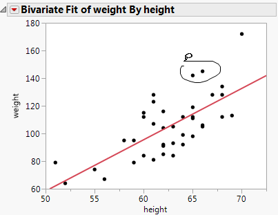

You can use the lasso tool to select points that fall in an irregular-shaped area. Any points marked in the data table as hidden are not selected. See
Hide Rows
in Enter and Edit Data
To select points within an irregularly shaped area, follow these steps:
1.
Click the lasso tool
in the toolbar.
2.
Click and hold the cursor (now lasso-shaped) in a plot.
Note:
To keep all points selected as you drag the lasso around several sets of points, press the Shift key before you click in the plot.
3.
Drag the lasso around any set of points.
Using the Lasso Tool
4.
Release the mouse. JMP automatically closes the lasso and highlights the points within the enclosed area.
