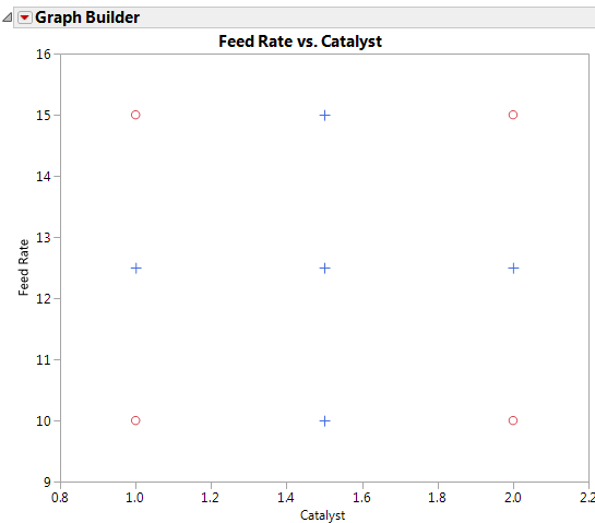

From the Augmented Design table, select Rows > Color or Mark by Column.
10.
Select Block, from Markers select Standard, and then click OK.
11.
Select Graph > Graph Builder.
12.
Drag Feed Rate to Y and drag Catalyst to X. Then click the smoother icon to remove.
Figure 5.17 Graphical View of the Augmented Design for Two Factors
