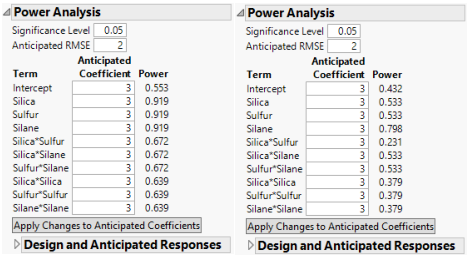

Type 2 next to Anticipated RMSE.
3.
5.
Figure 14.2 shows both outlines, with the Design and Anticipated Responses outline closed.
Figure 14.2 Power Analysis Outlines, Intended Design (Left) and Actual Design (Right)
The power values for the actual design are uniformly smaller than for the intended design. For Silica and Sulfur, the power of the tests in the intended design is almost twice the power in the actual design. For the Silica*Sulfur interaction, the power of the test in the actual design is 0.231, compared to 0.672 in the intended design. The actual design results in substantial loss of power in comparison with the intended design.

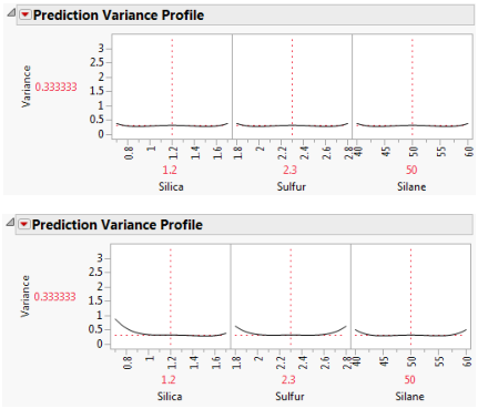

The plots are shown in Figure 14.5, with the plot for the intended design at the top and for the actual design at the bottom.
Figure 14.3 Prediction Variance Profile, Intended Design (Top) and Actual Design (Bottom)

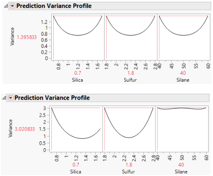

In both windows, select Maximize Variance from the Prediction Variance Profile red triangle menu.
Figure 14.4 shows the maximum relative prediction variance for the intended and actual designs.
Figure 14.4 Prediction Variance Profile Maximized, Intended Design (Top) and Actual Design (Bottom)
For both designs, the profilers identify the same point as one of the design points where the maximum prediction variance occurs: Silica=0.7, Sulfur=1.8, and Silane=40. The maximum prediction variance is 1.396 for the intended design, and 3.021 for the actual design. Note that there are other points where the prediction variance is maximized. The larger maximum prediction variance for the actual design means that predictions in parts of the design space are less accurate than they would have been had the intended design been conducted.

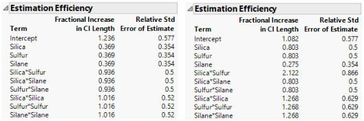

Figure 14.6 Estimation Efficiency Outlines, Intended Design (Left) and Actual Design (Right)
The Fractional Increase in CI Length compares the length of a parameter’s confidence interval as given by the current design to the length of such an interval given by an ideal design of the same run size. The length of the confidence interval, and consequently the Fractional Increase in CI Length, is affected by the number of runs. See Fractional Increase in CI Length. Despite the reduction in run size, for the actual design, the terms Silane, Silica*Silane, and Sulfur*Silane have a smaller increase than for the intended design. This is because the two runs that were removed to define the actual design had Silane set to its center point. By removing these runs, the widths of the confidence intervals for these parameters more closely resemble those of an ideal orthogonal design, which has no center points.

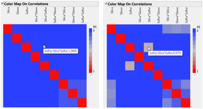

1.
Open the Color Map On Correlations outline.
Figure 14.7 Color Map on Correlations, Intended Design (Left) and Actual Design (Right)

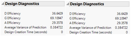

Figure 14.8 Design Diagnostics, Intended Design (Left) and Actual Design (Right)
Note that both the number of runs and the model matrix factor into the calculation of efficiency measures. In particular, the D-, G-, and A- efficiencies are calculated relative to the ideal design for the run size of the given design. It is not necessarily true that larger designs are more efficient than smaller designs. However, for a given number of factors, larger designs tend to have smaller Average Variance of Prediction values than do smaller designs. For details on how efficiency measures are defined, see Design Diagnostics.
