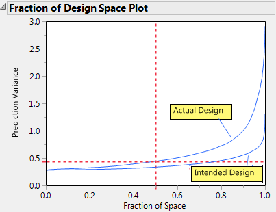

a fraction of design space plot, showing how much of the design space has prediction variance above a given value

Figure 14.1
Comparison of Two Fraction of Design Space Plots
