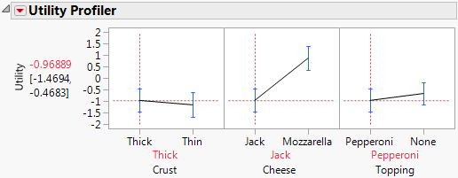

Figure 4.1
Choice Platform Utility Profiler
