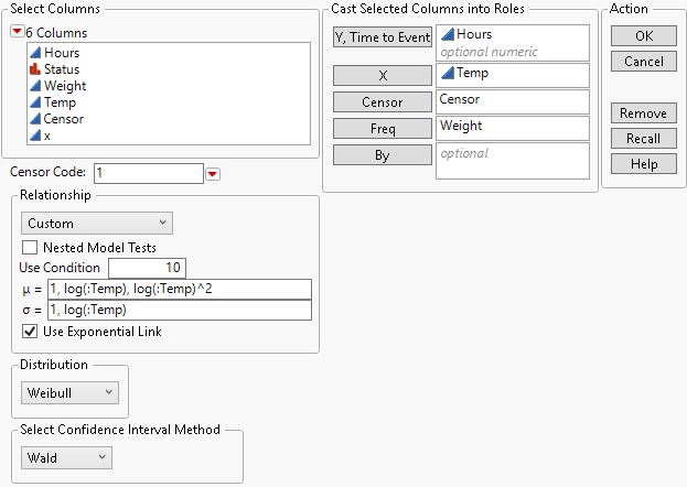

Figure 3.24 shows the completed launch window using the Custom option.
14.
Figure 3.24 Custom Relationship Specification in Fit Life by X Launch Window

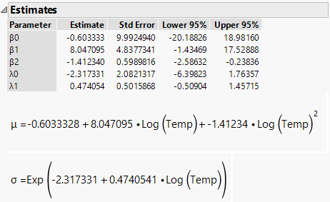

Figure 3.25 shows the location and scale transformations, which are subsequently created and included at the bottom of the Estimates report section.
Analysis proceeds similarly to the Example of the Fit Life by X Platform, where the Arrhenius Celsius Relationship was specified.
Figure 3.25 Weibull Estimates and Formulas for Custom Relationship
