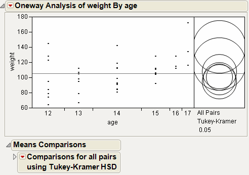

From the red triangle menu, select Compare Means > All Pairs, Tukey HSD.

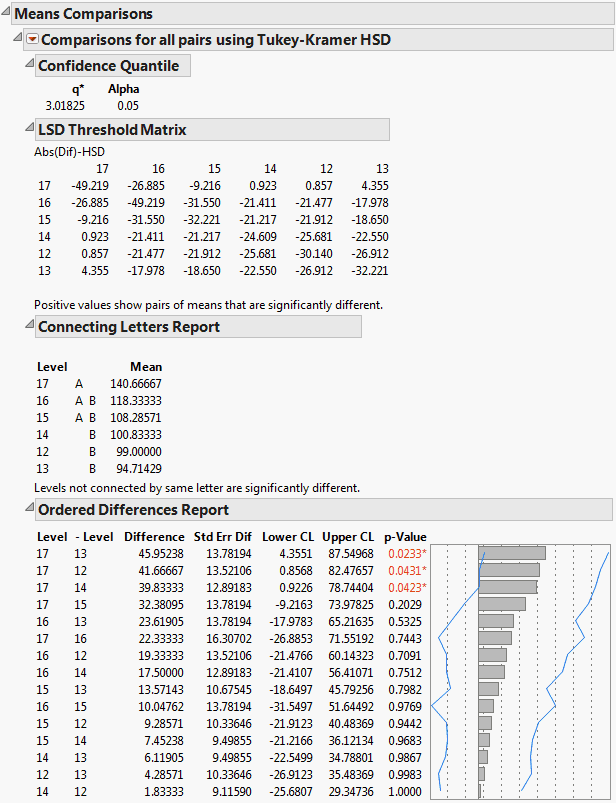

Figure 6.17 Example of All Pairs, Tukey HSD Comparison Circles
Figure 6.18 Example of Means Comparisons Report for All Pairs, Tukey HSD
In Figure 6.18, the Tukey-Kramer HSD Threshold matrix shows the actual absolute difference in the means minus the HSD, which is the difference that would be significant. Pairs with a positive value are significantly different. The q* (appearing above the HSD Threshold Matrix table) is the quantile that is used to scale the HSDs. It has a computational role comparable to a Student’s t.
