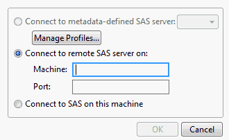

In the Connect to SAS Server window (see Figure 6.157), choose a method to connect to SAS (if you are not already connected). For this example, select Connect to SAS on this machine.
Figure 6.157 Connect to SAS Server

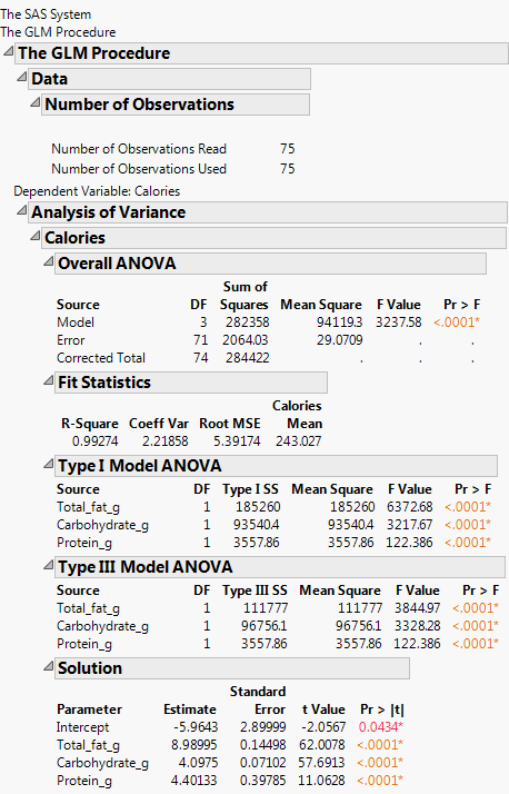

Figure 6.158 SAS Results Formatted as a JMP Report
