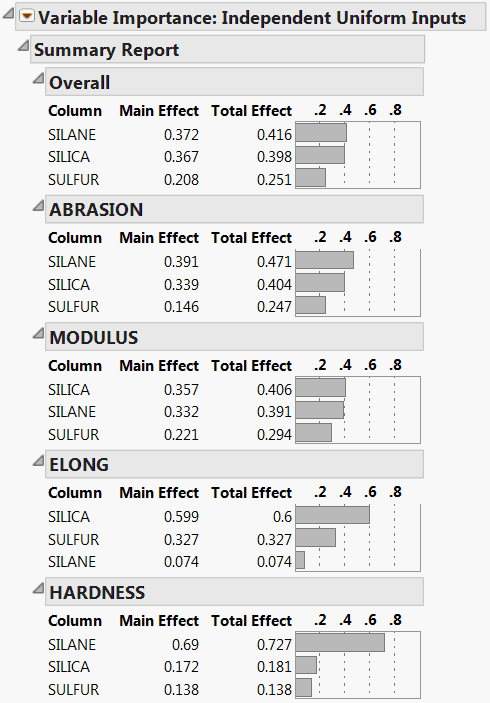

From the red triangle menu next to Prediction Profiler, select Assess Variable Importance > Independent Uniform Inputs.
The Summary Report is shown in Figure 2.28. Because the importance indices are based on random sampling, your estimates might differ slightly from those shown in the figure.
Figure 2.28 Summary Report for Four Responses

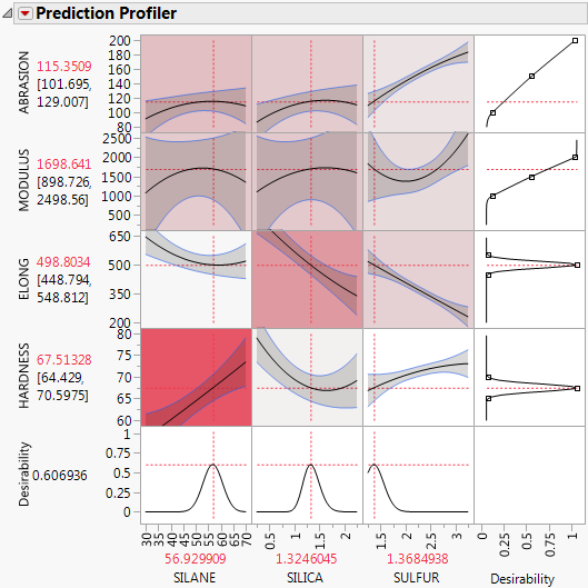

Figure 2.29 Prediction Profiler for Four Responses

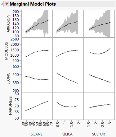

The Marginal Model Plots report (Figure 2.30) shows mean responses for each factor across a uniform distribution of settings for the other two factors.
Figure 2.30 Marginal Model Plots for Four Responses
