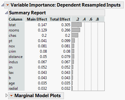

From the red triangle menu next to Prediction Profiler, select Assess Variable Importance > Dependent Resampled Inputs.
The Variable Importance: Dependent Resampled Inputs report appears (Figure 2.26). Check that the Prediction Profiler cells have been reordered by the magnitude of the Total Effect indices in the report. In Figure 2.26, check that the Total Effect importance indices identify rooms and lstat as the factors that have most impact on the predicted response.
Figure 2.26 Dependent Resampled Inputs Report

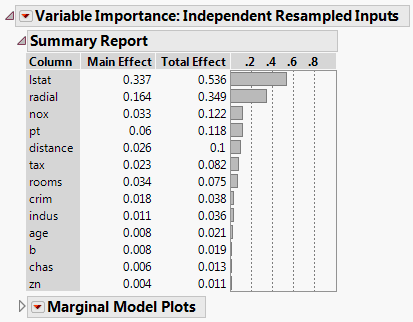

From the red triangle menu next to Prediction Profiler, select Assess Variable Importance > Independent Resampled Inputs.
Figure 2.27 Independent Resampled Inputs Report
