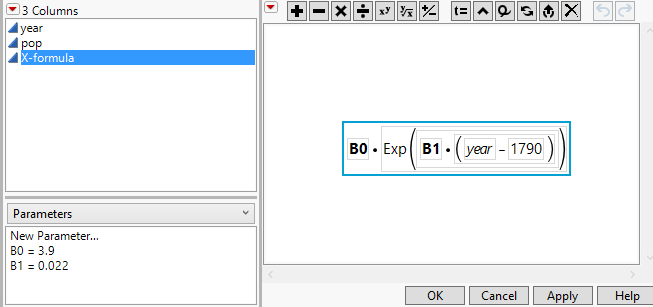

Select Help > Sample Data Library > Nonlinear Examples and open US Population.jmp.
Figure 3.40 Formula for Nonlinear Fit to Population

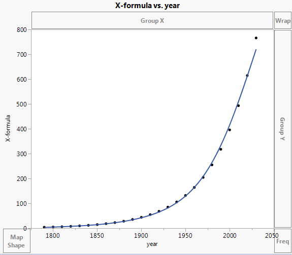

Figure 3.41 Points for Function Evaluated at Specified Years, with Smoother
Points are plotted for the years up to 2030. The points are the values of the function, X-formula, evaluated at the years in the year column. The function can be evaluated at the years for which pop is missing: 2010, 2020, and 2030. The smoother that is shown is only an approximation to the function. You want to see the function itself.

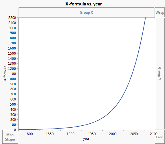

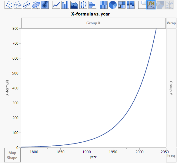

Figure 3.42 Graph of Function
9.
11.
Figure 3.43 Graph of Function to Year 2100

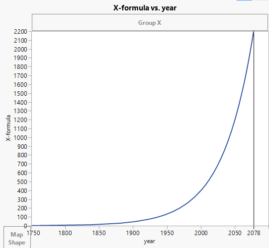

Click Add.
15.
Figure 3.44 Projected US Population at Year 2078

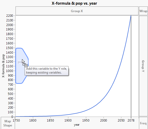

Drag pop just inside the Y axis to merge it with X-formula in the Y zone.
Figure 3.45 Merging pop with X-formula in the Y Zone

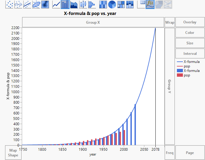

Figure 3.46 Bars Showing Values for pop and X-formula
18.
In the Bar options, click Variables and de-select Y X-formula.
Figure 3.47 Model Predictions to Year 2078 and Bars for Years with Data
