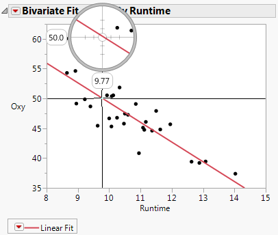

Use the crosshair tool as described below to approximate the Runtime value that results in a mean Oxy value of 50.
7.
Select Tools > Crosshairs.
8.
Click the Oxy axis at about 50 and then drag the cursor so that the crosshairs intersect with the prediction line.
Figure 2.34 shows that a Runtime of about 9.77 gives an inverse prediction of about 50 for Oxy.
Figure 2.34 Bivariate Fit for Fitness.jmp

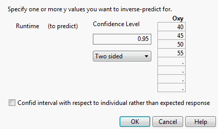

7.
Figure 2.35 Completed Inverse Prediction Specification Window

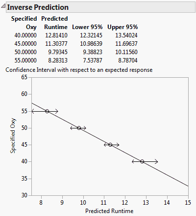

The Inverse Prediction report (Figure 2.36) gives predicted Runtime values that correspond to each specified Oxy value. The report also shows upper and lower 95% confidence limits for these Runtime values, relative to obtaining the mean response.
Figure 2.36 Inverse Prediction Report
The exact predicted Runtime resulting in an Oxy value of 50 is 9.7935. This value is close to the approximate Runtime value of 9.77 found in the Bivariate Fit report shown in Figure 2.34. The Inverse Prediction report also gives a plot showing the linear relationship between Oxy and Runtime and the confidence intervals.

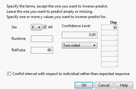

This example predicts the Runtime that results in oxygen uptake of 50 when RstPulse is 60. The Runtime is predicted for both males and females.
1.
From the Fitness.jmp sample data table, select Analyze > Fit Model.
2.
Select Oxy and click Y.
3.
Select Sex, Runtime, and RstPulse and then select Add.
4.
Click Run.
6.
Delete the value for Runtime, because you want to predict that value.
7.
Select the All box next to Sex to estimate Runtime for all levels of Sex.
8.
Replace the mean for RstPulse with 60.
10.
Figure 2.37 Inverse Prediction Specification for a Multiple Regression Model

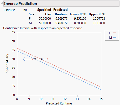

The report, shown in Figure 2.38, gives the predicted values of Runtime for both females and males. The report also includes 95% confidence intervals for Runtime values that give a mean response of 50.
Figure 2.38 Inverse Prediction Report for a Multiple Regression Model
The plot shows the linear fits for females and males, given that RstPulse is 60. The two confidence intervals are shown in red and blue, respectively. Note that the intervals overlap, indicating that the true values of Runtime leading to an Oxy value of 50 might be identical for both males and females.
