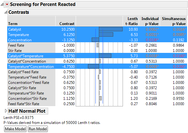

Insert LenthSimN=50000; as the first line of the script.
LenthSimN=50000;
Fit Two Level Screening(
	Y( :Percent Reacted),
	X( :Feed Rate, :Catalyst, :Stir Rate, :Temperature, :Concentration )
Figure 9.10 Fit Two Level with N = 50,000 Simulations for p-Value Derivations
Note: If LenthSimN=0, the standard t-distribution is used and simultaneous p-values are not provided. This approach is not recommended.
