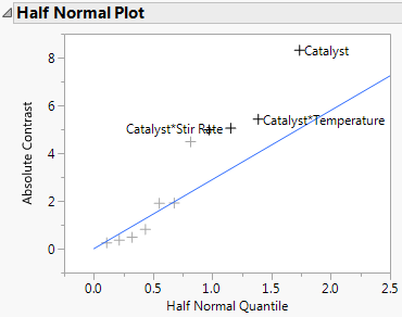

The Fit Two Level Screening platform is based on the principle of effect sparsity (Box and Meyer 1986). This principle asserts that relatively few of the effects that you study in a screening design are active. Most are inactive, meaning that their true effects are negligible and that their estimates can be treated as random error.
Figure 9.1 Half Normal Plot from Fit Two Level Screening Report
