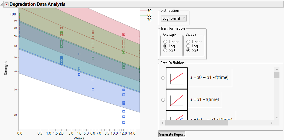

Figure 7.12 Common Slope Model Using a Lognormal Distribution

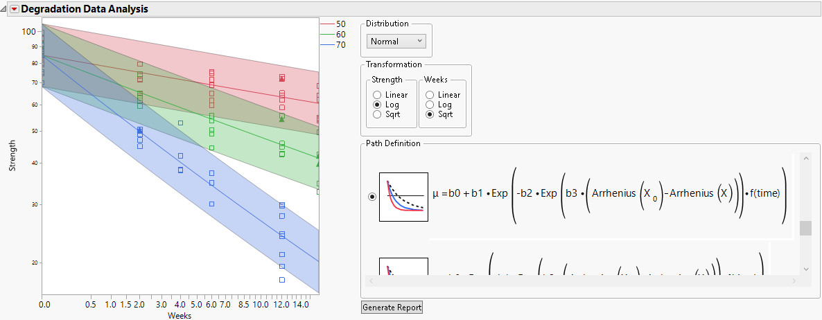

In this model, both b1 and b2 are positive. Because of the sign preceding b1 is the opposite of the sign preceding b1 in the Type 1 model, this model is an inverted version of the Type 1 model. On a linear scale, it has a lower asymptote at b0 as time approaches infinity.
Given data exhibiting a negative slope over time, the fitted model can produce a plot similar to Figure 7.13. The figure is for Adhesive Bond.jmp. The selected temperature measurement scale is Celsius and the specified temperature under typical use conditions is 35 degrees.
Figure 7.13 Example of First-Order Kinetics Model Type 3
