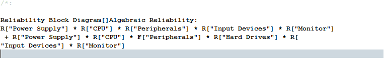

The Print Algebraic Reliability to the Log Window command prints the reliability formula for the selected system diagram to the Log window.
1.
2.
Open the exampleRBDcomplete.jsl file that you created.
4.
From the Computer red triangle menu select Print Algebraic Reliability to the Log Window.
Figure 10.29 Algebraic Reliability in Log Window
