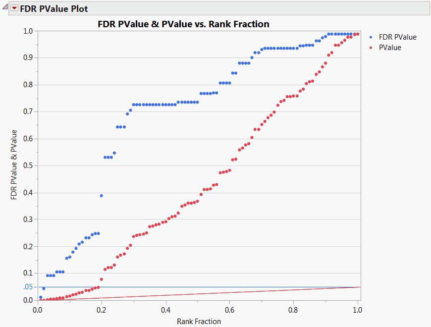

Figure 17.1
Example of a Response Screening Plot
