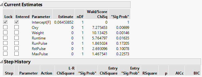

Figure 4.10 Step History for a Categorical Response before First Step

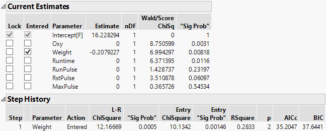

Figure 4.11 Step History for a Categorical Response after First Step
Note that the Entry ChiSquare and Entry “Sig Prob” values for Weight in the Step History table in Figure 4.11 match the Wald/Score ChiSq and “Sig Prob” values for Weight in Figure 4.10.
