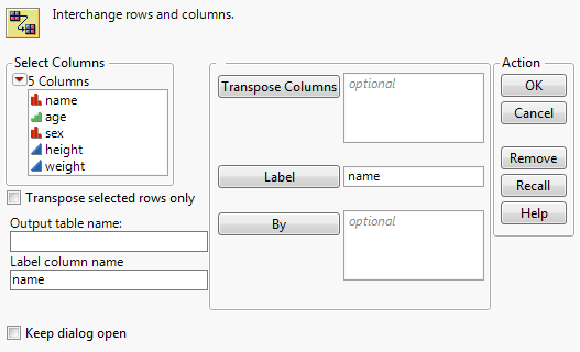

Select Tables > Transpose.
Figure 5.15 Transpose Window
4.
Click Transpose Columns.
6.
2.
Click Label. The column name appears in the Label box.
The default column name is Label. You can specify an alternative name for the column using the Label column name option. Only one column is created for each distinct value in the label column. Therefore, if there are duplicate values in the label column, JMP creates only one column for the duplicated value using the value from the last duplicated row.
2.
Table 5.1 describes the rules that apply to transposing.
The column names in the transposed table are Row 1, Row 2, …, Row n where n is the number of rows in the original table.
