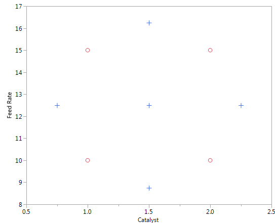

Figure 6.1
Original Design Runs (+) with Augmented Runs (o)
