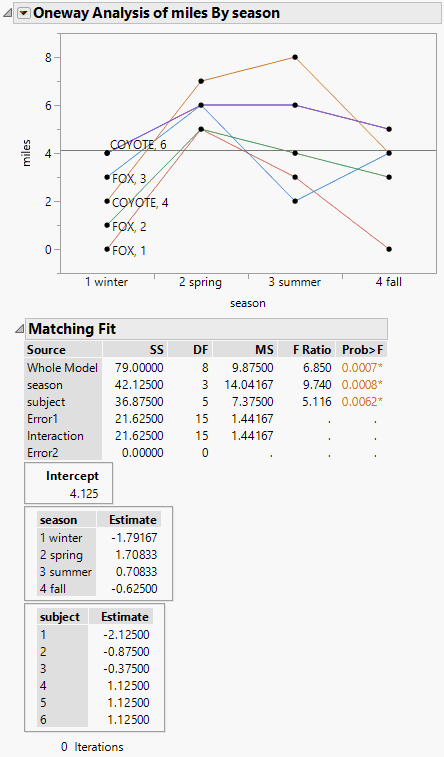

This example uses the Matching.jmp sample data table, which contains data on six animals and the miles that they travel during different seasons.
1.
Select Help > Sample Data Library and open Matching.jmp.
2.
Select Analyze > Fit Y by X.
3.
Select miles and click Y, Response.
4.
Select season and click X, Factor.
5.
7.
Select subject as the matching column.
8.
Figure 6.37 Example of the Matching Column Report
The Matching Fit report shows the season and subject effects with F tests. These are equivalent to the tests that you get with the Fit Model platform if you run two models, one with the interaction term and one without. If there are only two levels, then the F test is equivalent to the paired t-test.
