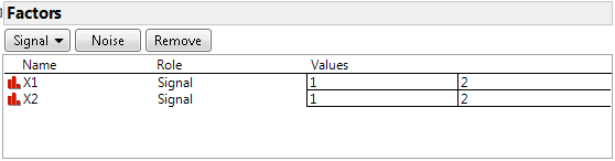

Factors
Use the Factors outline to specify factors.
Signal
Specify two or more 2- or 3-level signal factors. Signal factors are system control inputs. These are factors that you can control in production.
Noise
Specify one or more noise factors. Noise factors are variables that are difficult or expensive to control in production. However, you must be able to control noise factors during the experiment. Click Noise to add a noise factor.
Remove
Removes the selected factors.
Name
The name of the factor. When added, a factor is given a default name of
X1
X2
, and so on. To change this name, double-click it and enter a different name.
Role
Specifies the Design Role (Signal or Noise) of the factor. This is set when you add the factor.
Values
The experimental settings for the factors. To insert Values, click on the default values and enter the desired values.
Figure 14.10
Factors Outline
