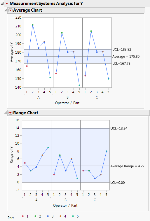

Figure 8.1
Example of a Measurement System Analysis
