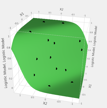

Figure 23.1
Design Points for a Nonlinear Model
