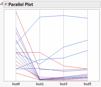

The Parallel Plot
To produce the plot shown in
Figure 9.5
, follow the instructions in
Example of a Parallel Plot
Figure 9.5
The Parallel Plot Report
A parallel plot is one of the few types of coordinate plots that show any number of variables in one plot. However, the relationships between variables might be evident only in the following circumstances:
when the variables are side by side
if you assign a color to a level of a variable to track groups
if you select lines to track groups
