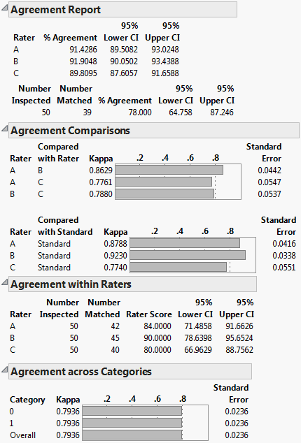

The Agreement Report shows agreement summarized for each rater and overall agreement. This report is a numeric form of the data presented in the second chart in the Attribute Gauge Chart report. See Figure 9.5.
The Agreement within Raters report shows the number of items that were inspected. The confidence intervals are score confidence intervals, as suggested by Agresti and Coull (1998). The Number Matched is the sum of the number of items inspected, where the rater agreed with him or herself on each inspection of an individual item. The Rater Score is the Number Matched divided by the Number Inspected.
Figure 9.6 Agreement Reports
