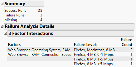

Figure 19.7 Analysis of Software Experimental Data

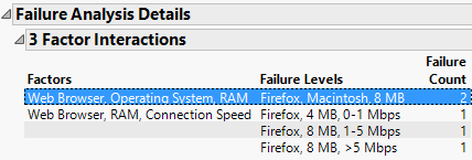

Two failures were associated with Web Browser set to Firefox, Operating System set to Macintosh, and RAM set to 8 MB. Notice that this combination led to failure regardless of the setting of Connection Speed.
Figure 19.8 Selection of an Interaction in the Analysis Report

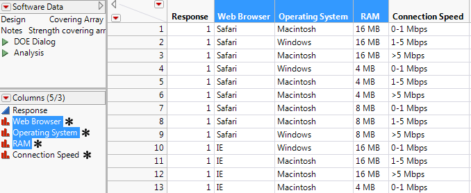

Figure 19.9 Corresponding Selection of Rows and Columns in the Data Table
Three failures were associated with combinations of Web Browser, RAM, and Connection Speed. Note that two of these failures, Firefox, 8 MB, 1-5 Mbps and Firefox, 8 MB, >5 Mbps, are among the two failures for the Web Browser, Operating System, and RAM interaction. Selecting any of these rows in the report selects the corresponding rows and columns in the data table.
