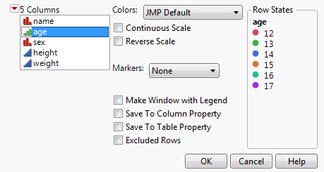

You can assign colors or markers to your data table rows based on the values found in a particular column. For example, in a column called Sex, you could assign all rows whose value is F a red circle marker. All rows whose value is M could have a green plus marker. These colors and markers replace the default black dot in plots and appear next to its row number in the data table.
1.
Select Rows > Color or Mark by Column.
Figure 3.28 Color or Mark by Column
3.
Select the Colors and Markers schemes to apply.
