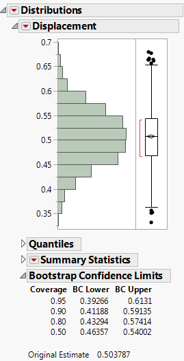

Figure 10.175
Bootstrapping Results for a Slope Parameter
