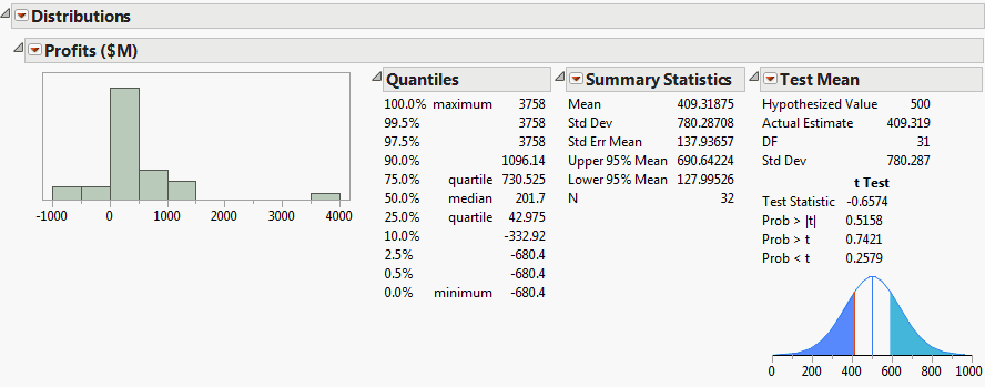

From the red triangle menu next to Profits ($M), deselect Outlier Box Plot to turn the option off.
8.
Type 500 in the Specify Hypothesized Mean box.
9.
Figure 2.1 Customized Distribution Report

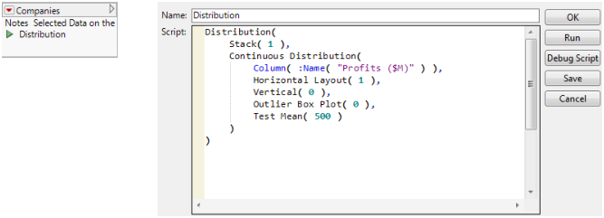

Figure 2.2 Distribution Script Saved to the Data Table
