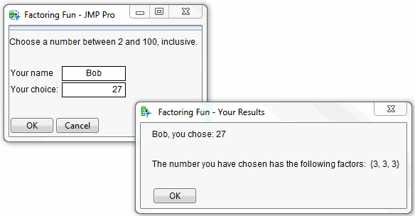

Prime Numbers.jsl asks the user to enter a number and then factors the number or confirms it as a prime number (Figure 16.5). This script is a good example of aligning several types of display boxes, concatenating text, and working with conditional functions.
/* How do you gather numeric input from the users, perform a
calculation on that input, and show the results in a new window?
This script demonstrates how to create an interactive program that
it as a prime number. */

Figure 16.5 Factor Numbers Interactively
