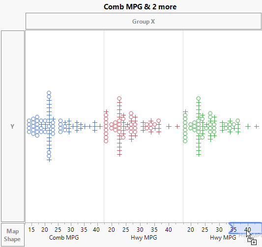

If you want more control over where the variables appear, drag them individually. Drag additional variables above, below, or between existing variables in the X zone.
Figure 2.12
Dragging a Variable to the Right of the Existing Variable
A single polygonal shape indicates when your variable is in the appropriate target zone.

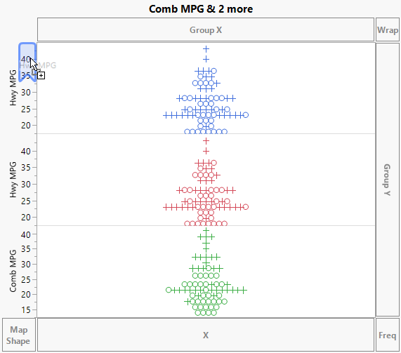

If you want more control over where the variables appear, drag them individually. Drag additional variables above, below, or between existing variables in the Y zone.
Figure 2.13
Dragging a Variable above the Existing Variable
