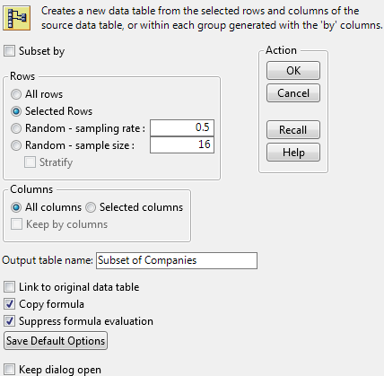

Select Tables > Subset to launch the Subset window.
Figure 1.36 Subset Window
8.
Select Selected columns to subset only the columns that you selected. You can also customize your subset table further by selecting additional options.
