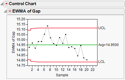

Select Sample and click Sample Label.
5.
Change the Weight to 0.5.
6.
Figure 3.26 EWMA Chart
The EWMA chart appears for the same data shown in Figure 3.25. This EWMA chart was generated for weight = 0.5.
