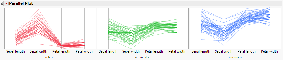

From Figure 8.10, you observe the following:
1.
From the Iris.jmp sample data table, select Graph > Parallel Plot.
2.
Select Sepal length, Sepal width, Petal length, and Petal width and click Y, Response.
3.
Select Species and click X, Grouping.
4.
Figure 8.11 Three Species in Different Parallel Plots
